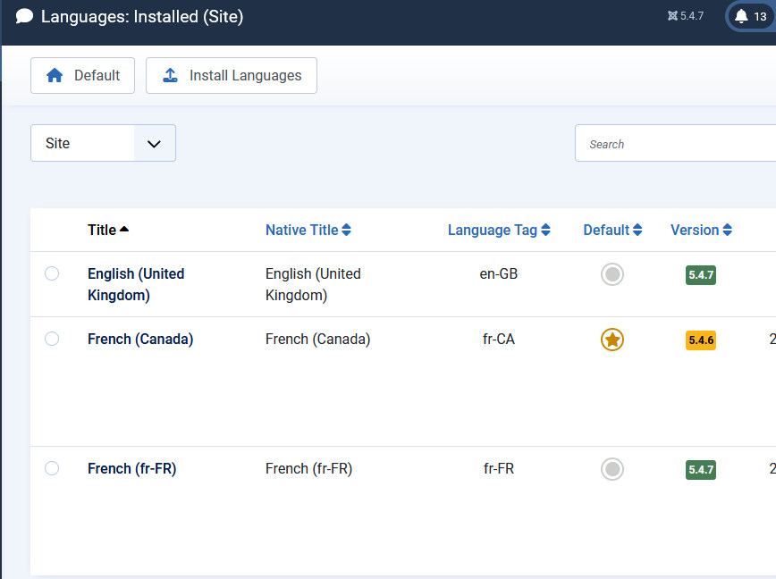

Now I'am facing this error when a new user want to make the first registration see the link bellow, Try yourself to make a new registration to see the error, you can use same information to log on backend of my clone app (Shaper-Educon Template 0 3 arguments are required, 2 given When the new user, after filling in all the fields, clicks the "Register" button, they get the error below. Despite this error, the user doesn't know if their registration was successful. However, as the administrator, I can see in the Joomla site's backend that the user account was created despite the error. This is also why the user doesn't receive a confirmation or email to validate their email address. But as the administrator, I can see in the backend of my Joomla site that the user was created despite the error. This is also why the user doesn't receive a confirmation or validation email for their email address.

Solved. Problem was becuase after Joomla 3>Joomla 5 upgrade you forgot to update Joomla language files for FR / FR-Ca, only EN was current. And for Joomla it was technical problem.
Here you had old language files, for old CMS version, yes, I updated already

Hello Paul Thank you very much, the problem is indeed fixed after the FR/CA language update. The only thing is that the confirmation and activation email wasn't sent. I deleted the unused copy of the template.
