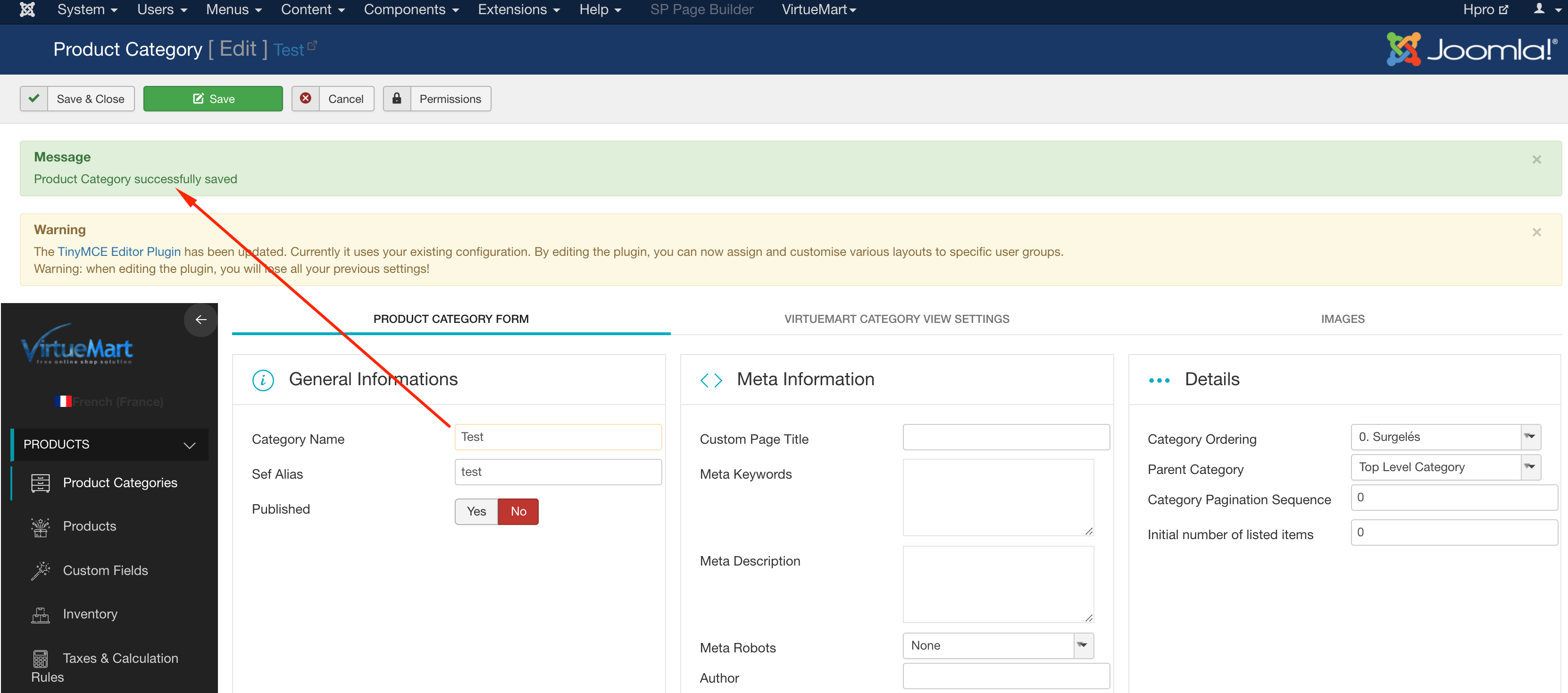

Support Agent 5 years ago #23454
I have installed the backup on my localhost and added a category. Please check your issue again.

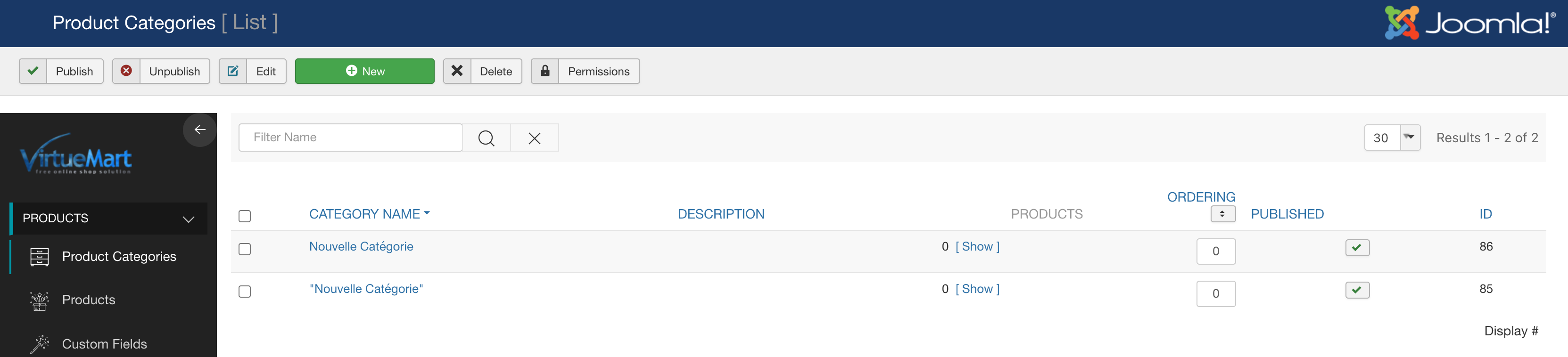

MELISSA MOUHEB
5 years ago #23608
Ok, So Go to Vituemart Category > New Catégory Add for example "Nouvelle Catégorie" (With the accent) And Save
It will tell you : 1267 Illegal mix of collations (utf8_general_ci,IMPLICIT) and (utf8mb4_general_ci,COERCIBLE) for operation '='
