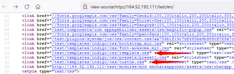

sorry, I see the problem,
it's becuse custom.css is loaded before template.css - yes, it shouldn't be like that. Tomorrow I will ask developer.

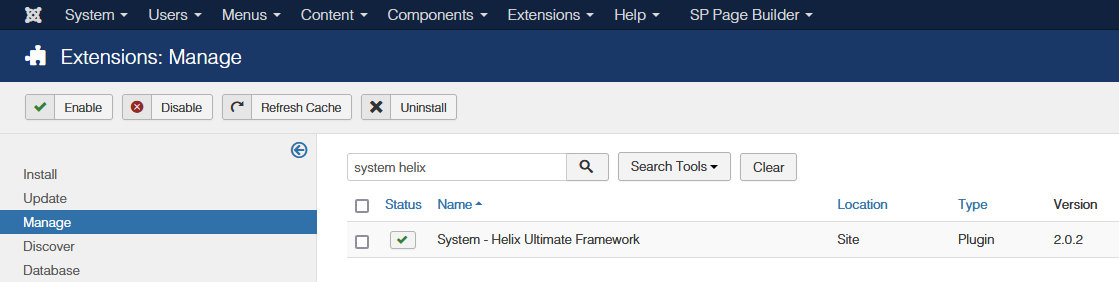

What Helix Ultimate plugin (System - Helix Ultimate Framework ) you have installed 2.0.0, 2.0.1 or 2.0.2 ?
I have Helix Ultimate Framework 2.0.2

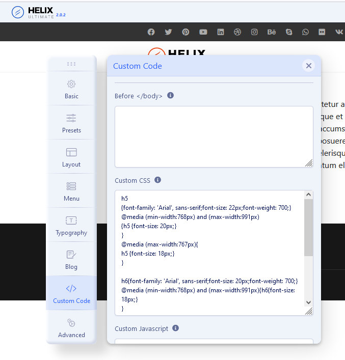

We are seeing this same issue here. Custom css in the code editor in the Template manager is all janky. Thanks for your awesome help Paul. Looking forward to a fix.
![http://45.79.80.230/images/screen-shot-2021-08-31-at-6.47.21-am.png]
Just to confirm, this is on native Helix Ultimate, not another theme. We are seeign this on all of our HelixUltimate sites.
Steve, my suggestion is (and was) to use custom.css file, not custom CSS field.
About your issue, do you have maybe code that you used, so I can share with developer for deeper investigation.
Update Helix System Plugin - must be also 2.0.2 (!)

please check & make sure that your Helix System plugin is in v2.0.2
Thanks, Paul. It is updated to 2.0.2. For Indigo template, the custom.css file still isn't readable. I was advised to copy the custom.css code and paste it into the template's custom css.

Tested v 2.0.3 on a test site. The custom.css file is being read now but there seems to be some issue where some css codes are not being read.
I installed the custom code on an identical site after upgrading to v2.0.3 http://164.52.192.111/test/en/
and this is another (with the same custom code) http://persiankebab.ae/en/
Notice the difference? Is this happening because certain files cannot be overridden in template.css?

About custom.css is loaded after template.css - so this part is correct.
but on your 2nd link, some CSS was added inside Template Options - Custom Code - Custom CSS
and that part you didn't used on test domain.
