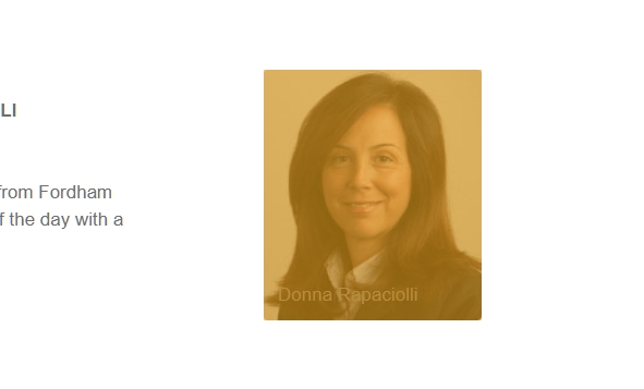

4 years ago #39670
I wonder if there is a way to add CSS to the image model popup to make it behave as an overlay on hover?
Hi. Yes, it is possible to do through CSS. But so that it was a beautiful name must be placed inside the image, since the overlay layer applies to both.
Add "modal-overlay" class name to the addon CSS Class field. And use following code (add it to the costom.css file):
.modal-overlay .sppb-modal-selector {
    position: relative;
.modal-overlay .sppb-modal-selector::before {
    content: '';
    position: absolute;
    left: 0;
    top: 0;
    width: 100%;
    height: 100%;
    background-color: rgba(234, 163, 27, 0.6);
    z-index: 2;
    opacity: 0;
    transition: opacity .3s;
.modal-overlay .sppb-modal-selector .text {
    position: absolute;
    left: 15px;
    bottom: 15px;
.modal-overlay .sppb-modal-selector:hover::before {
    opacity: 1;
Will looks like this
After all, you should pick up a different font color.

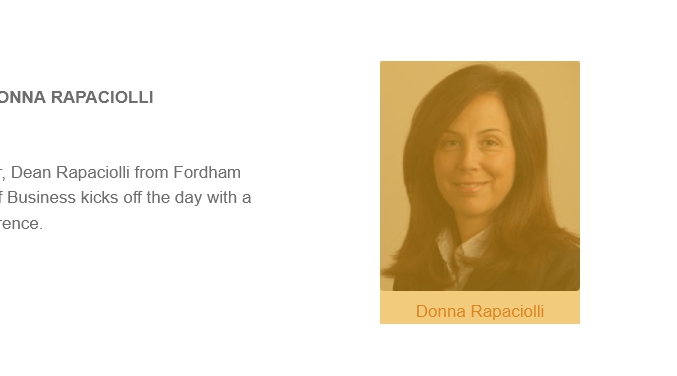

4 years ago #39680
Pavel, this is brilliant. Thank you so much for this! It works perfectly and gives the user a much better experience.
For anyone else looking at this post, I also made one edit to the CSS Pavel posted above so that the text field displays below the image. So instead of
    position: absolute;
    left: 15px;
    bottom: 15px;
I used:
    display: inline-grid;
.sppb-modal-selector span.text {
  margin-top: 8px;
4 years ago #39734
Hi Karen. You are wellcome.
  margin-top: 8px;
Do not forget to use your unique class for addon, so that the code would be isolated and did not influence other modal addons that you may want to use in another page, with another appearance.
