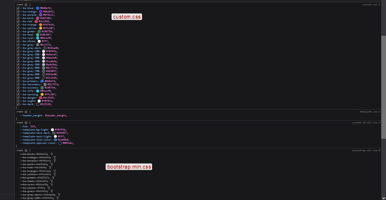

Hi. This should not build bootstrap.css. SCSS variables have other syntax and are used only inside SCSS but are not compiled in CSS. Only their values are compiled.
When you wrote code in custom.scss and saved, a new file is created in /templates/shaper_helixultimate/css/custom-compiled.css. This file is connected below bootstrap.min.css and overrides it. So, everything works.
If you expected it to change the core template's files , you are mistaken. That would break the template. Therefore, only override is possible.
After all bootstrap.min.css is a static CSS file. And for its generation inside Helix is not used SCSS. Therefore, if you want to override BS variables for using in CSS files, add them to custom.css (in main css sintax) and change values as you want.
Then you will see that it is overriden in custom.css
If you want to continue using Helix and receive updates, you cannot use anything other than override. Otherwise, create your own template based on Helix and delete everything you not needed. There is not other way

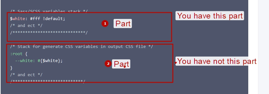

Hi Jean. For clarity, I'm not a member of the joomshaper team. Just a user.
:root {
$white: #fff;
/* and ect */
This is not the correct. I wrote about adding it to CSS but not in SCSS.
Sass / SCSS variables appeared much earlier than CSS variables. This is not the same thing. If you want to generate CSS variables in the output CSS file, you need to use two stacks of variables in your SCSS file. Then you will get everything you want in custom-compiled.css .
/* Sass/SCSS variables stack */
$white: #fff !default;
/* and ect */
/* Stack for generate CSS variables in output CSS file */
:root {
--white: #{$white};
/* and ect */
Perhaps there are something to automate this. Look at the Bootstrap source scss code. I am not a fan of preprocessors, so I do not know for sure.

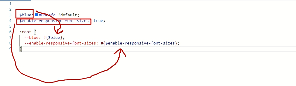

} Hi. If you carefully look at the code in my post above, you will see errors. In your root {...} section, everything is not right.

Mandatory syntax --var: #{SCSS-var-here}
:root {
--var: #{SCSS-var-here};
Any calculations of the values in :root {...} should be made only through CSS syntax and CSS functions, such as calc(), but not through SCSS syntax.
Why do you need SCSS if you do not understand this? Use CSS and all this headache does not need.

Just open the browser code inspector, find variables, copy, paste into your custom.css file and change how you need. This is all that required. Not needed SCSS in general
nope, does not work.
Even your code with simply warning will not correct bootstrap colors.

It sould be
:root {
--bs-warning: #{$warning};
} Look at the browser code inspector to see the correct variable names
