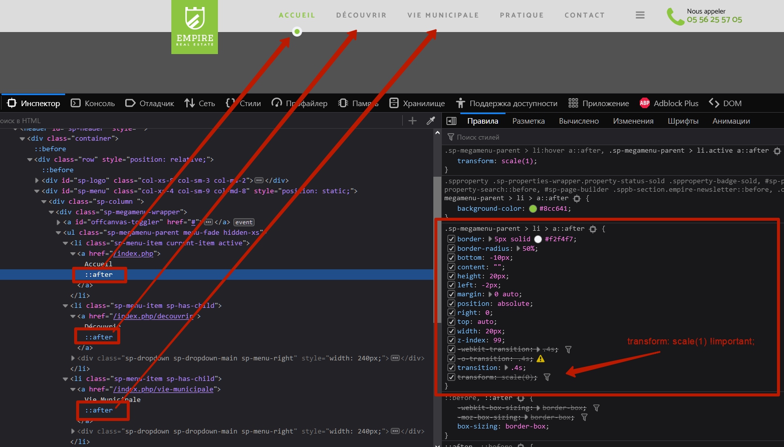

No, I'm talking about this green button (which is not a button but I dont know how to call that...)
https://demo5.ovh/images/2021-11-18_11-01-32.jpg
Is that possible add it under every link menu and not just on over ?
And is it possible to custom their color (one different color for every menu link ) ?
For the menu, I tried to put !imoportant like you told me but it's just transparent when I scroll down. I'd like to see the content of my main body (the slider of my home page) by transparence under the menu. Could you explain me how to do this ?

What about those green buttons (which are not buttons but I dont know how to call that...) https://demo5.ovh/images/2021-11-18_11-01-32.jpg Is that possible add it under every link menu and not just on over ? And is it possible to custom their color (one different color for every menu link ) ?
Hi.
This is possible. But the CSS skills will be required. Through the code inspector, you can define an element that you need to change.
If you want these elements to be constantly displayed, you need to release their code from under the influence of :hover and .active class.
.sp-megamenu-parent > li > a::after {
    transform: scale(1) !important;
If you want different colors for each menu item, you need to add an unique class to each menu item link and use it to configure unique color.
Something like
.sp-megamenu-parent > li > a.your-class-for-red-color::after {
    background-color: red;
.sp-megamenu-parent > li > a.your-class-for-yellow-color::after {
    background-color: yellow;
/* ...and ect... */
or use :nth-child() pseudo-class for <li>
