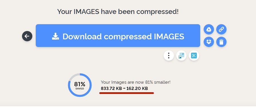

Hi. Start with image optimization. They are very large and their upload takes a lot of time, which interrupts the upload of the DOM elements in general and creates caching overload in the browser.
I checked one of your images and this is 834 Kb (almost 1 MB !!!). This is a lot. You can сompressed them at least 5-6 times. https://www.iloveimg.com/compress-image

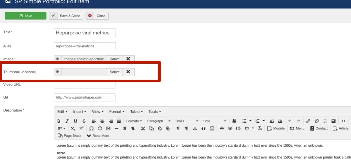

Separately, be sure to create thumbnails for the list, with a real size which is necessary for them.
I do not know whether it will certainly solve your problem. But in general it will well affect the speed of the page. And this is at least one of the factors that may be the cause.
