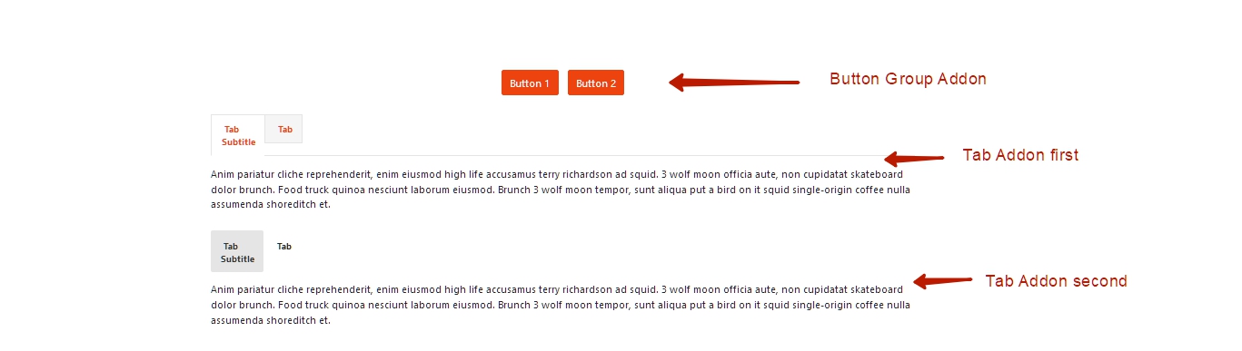

I have a site where I would like a button (or navigation item) to trigger the tabs addon in the same window. For example button #1 would open the tabs addon directly underneath it. The tabs contains an agenda for a day 1. Button #2 would trigger the tabs addon for day 2 agenda.
(Button#1) (Button #2)
Agenda Day 1 (tabs) Agenda Day 2 (tabs)
subj1| subj2 |subj3 subj1| subj2 |subj3
Is there another way to achive this with Page Builder? hope this makes sense.
Hi. It's not so difficult if you add a little jQuery and CSS.
Create a similar structure.

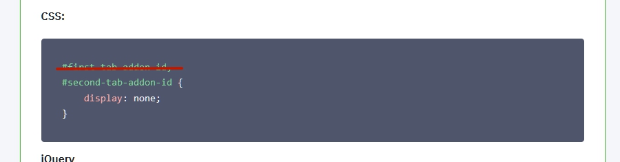

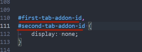

CSS:
#first-tab-addon-id,
#second-tab-addon-id {
    display: none;

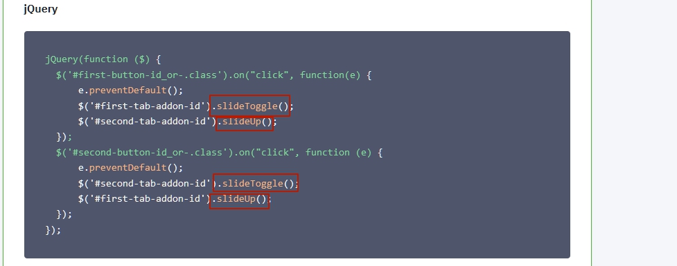

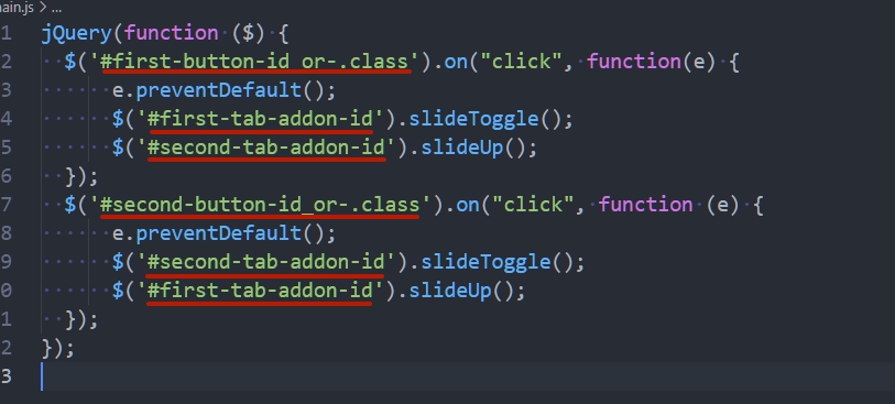

jQuery
jQuery(function ($) {
  $('#first-button-id_or-.class').on("click", function(e) {
      e.preventDefault();
      $('#first-tab-addon-id').slideToggle();
      $('#second-tab-addon-id').slideUp();
  $('#second-button-id_or-.class').on("click", function (e) {
      e.preventDefault();
      $('#second-tab-addon-id').slideToggle();
      $('#first-tab-addon-id').slideUp();
Replace it with selectors of your addons

When the page load 1st time, have only buttons displayed. No tab addons displayed.
Hi. Yes, in my code it is so conceived. If you need that the first tab addon will be visible when the page is loaded, delete the selector of this addon from CSS.

You can use any other jQuery display methods instead of these.
https://www.w3schools.com/jquery/jquery_ref_effects.asp

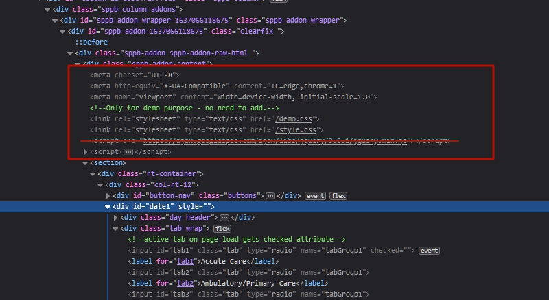

but the page load is very slow
You added things that should not be in body and you have connected another jQuery library. JQuery is already on board, connecting another additional version can cause conflicts and problems with the speed of the page.
All this should not be in body. Meta tags not need at all.
