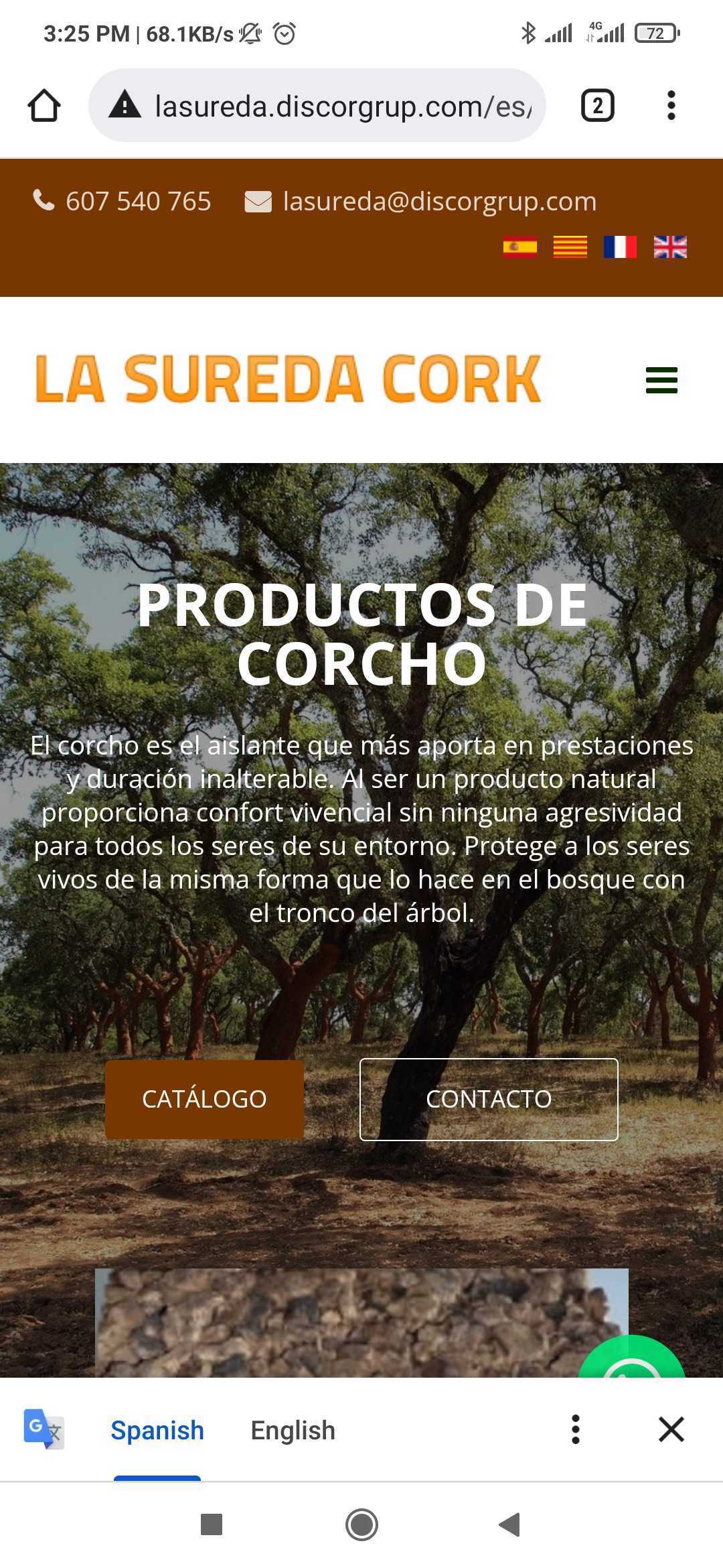

I have a question. I have a long left menu on my Educon webpage with a left menu. But when I access to my website with a mobile phone, the left menu occupies a top position, and I would like to position the left menu under the content (as it was a right menu, but being a left menu on the complet version and being under the content on the responsive mobile version).
I attach two screenshots:
https://ibb.co/8mgCdY6 https://ibb.co/9Z3K99x
Thank you very much

The left menu appears on all the pages but not on the home page. If I browse another page different from the gomepage the left menu appears above the content. This is what I mean (Screenshot link here: https://ibb.co/SNfB7BS).
Thank you very much,
Josep Mencion Seguranyes
