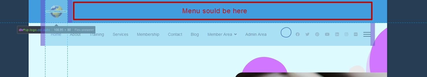

I used one of the default presets. I want the Menu text apear on a solid color background (i.e black), bt the menu backgreound seems to be transparent. Where is the setting forthis ? I cannot seem to find it
Why the social icons show up at the top if the entire feature is disabled in the template settings ?
https://ibb.co/NZ2vxJM

4 years ago #51147
Hi. You have boxed layout which limits the width. And a menu that contains too many items to fit in one line with the logo. Therefore, it is shifted below.
To do this, there is a configuration of the header background. Due to the shift menu, it is outside the Header, as Header has a specific height of 80px.
Create your own Header. This will solve all the problems. Find about it in Helix documentation.

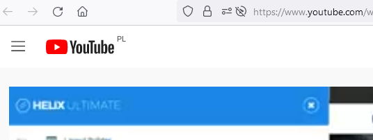

Paul - thanks for replying , but you really need to verify before you post something. The templated edit screen I see is completely different from what's on this video. I use HELIX ULTIMATE template, with Joomla4, so I do not know why this is so different. To be honest the way the editing this twmplate works (I mean floating interfacve, with super small tiny fonts) is really not what I woudl expect. What I see on the video looks much better, but thats is not what I get and how to get to this editing ? The video also does not show what version of the template is this (which is very unfortunate!).
I simply select Template_Styles > helix-ultimate >Template Options https://ibb.co/xSgKPJ4
this (selected preset) clearly shows MENU iten on top of the header, but when selected it's completely different WHY IS THAT ? BUGS ?
https://ibb.co/NY74Sks am I doing something wrong ?
Are you sure? I see template name here. I know it's for HU 1.1.x but in 2.0 it's still quite similar.

OK, Payul thank you for your insight. Finally I figured out what is causing the problem and this has been reported in another post. Avtually the problem is with Helix Ultimate template. IT simply does not position Social Icons and they remain at the top causing Menu shifted below. When those icons are completely disabled everything goes back to normal. If you check my other posts there is more details and screenshots.
