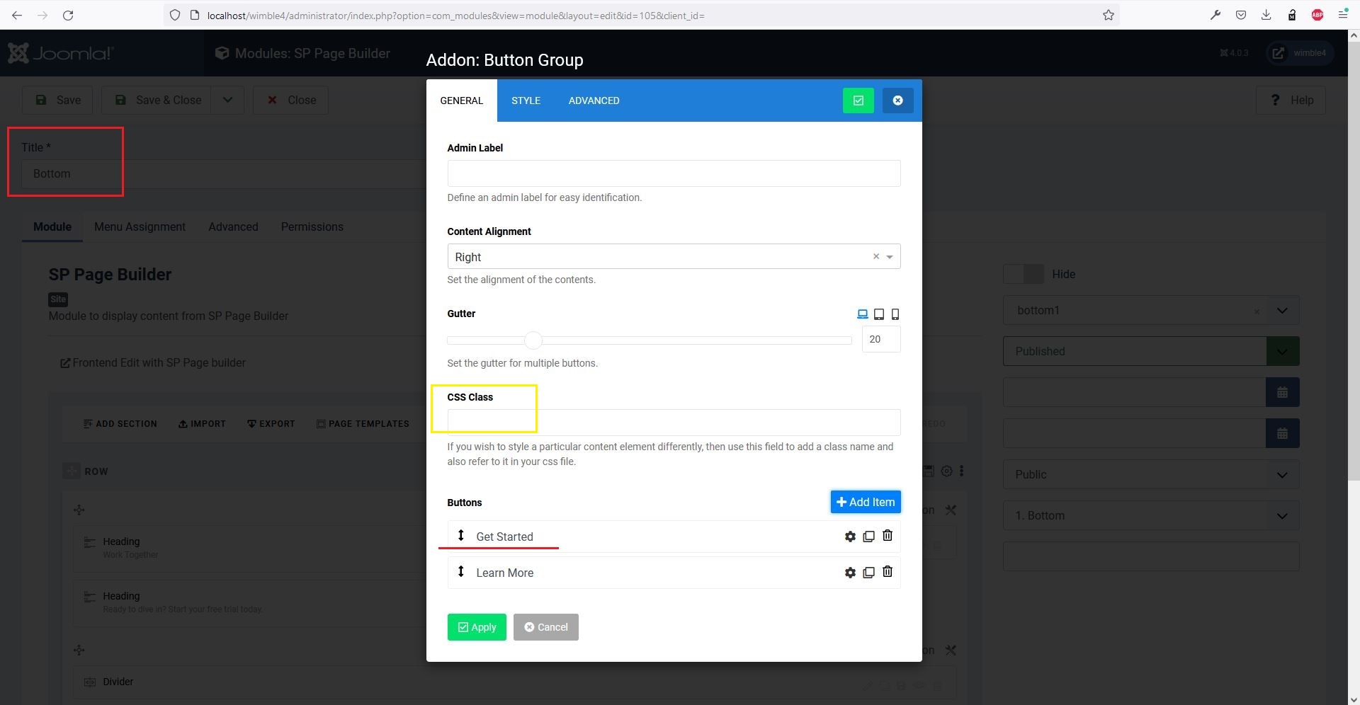

Kindly check this documentation link: https://www.joomshaper.com/documentation/joomla-templates/wimble/bottom-layout-settings
You need to open "Bottom" module, inside "button group" the first button is the "Get Started" button. You can choose a different button style from there. Otherwise, you can provide a CSS class name and you will be able to add gradient with custom css.

Sorry but I couldn't do it.
I started with the module button at the bottom of the acymailing page but I can't find the place to change it in SPPB or the button hover
