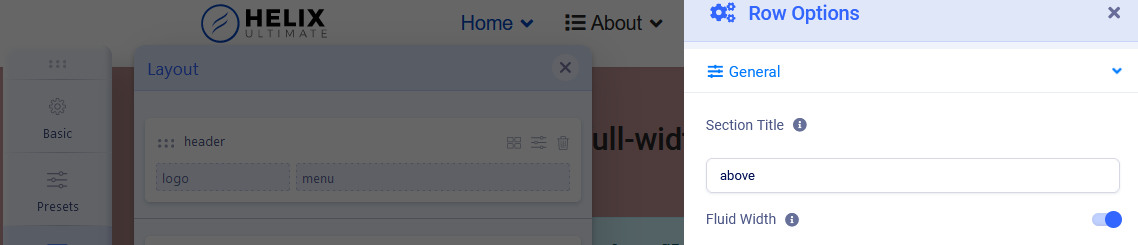

Thanks for that, the next thing is how do I make that module postion go full width please
It's possible only for new module position - just in Row Option - Fluid Width : On
