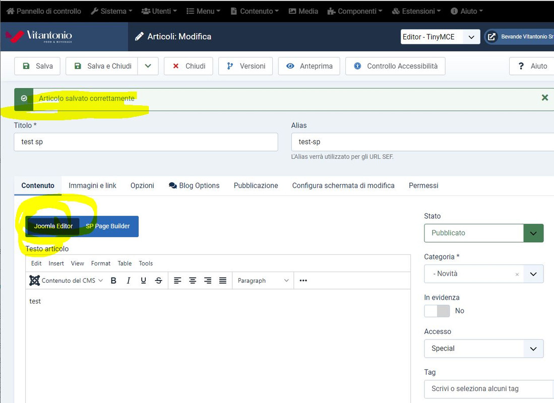

Hi, I have correctly configured the plugin to use SP PAGE BUILDER within the Joomla articles. In fact I see the edit button inside the articles, but when I save them, they remain with the contents of the standard editor.
Attached are some screenshots.
In the first I have selected the SP PAGE BUILDER tag,
in the second, after saving, we notice how Joomla takes into consideration the other editor again.
Hope you can help me. Thanks

excuse me, you can see from the attached photo that there are no elements in the SP PAGE BUILDER form, do I need to create them first? from the videos I saw on usage I understood that I just had to save the article by selecting the sp page builder tab and then create the contents from the front-end. In any case I tried both to save without elements in the sp page builder tab, and to save some elements. On saving, any element entered in the sp page builder disappears. I am attaching a video
