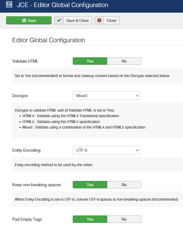

BTW My default JCE settings

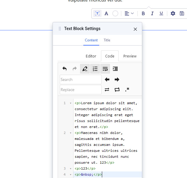

Here is a step by step for the purity of the experiment.
Using SPPB 3, I add a text addon. I put the cursor at the end of the text and press Enter to get p.
Everything is clean in the code.
I update to SPPB 4. Add a new text addon. I put the cursor at the end of the text and press Enter to get p.
Now in the code is garbage.
I assume that the mce-data... elements are service elements from JCE and they work when editing only. In live page they should be cleaned. At least in SPPB 3, but not in SPPB 4.
