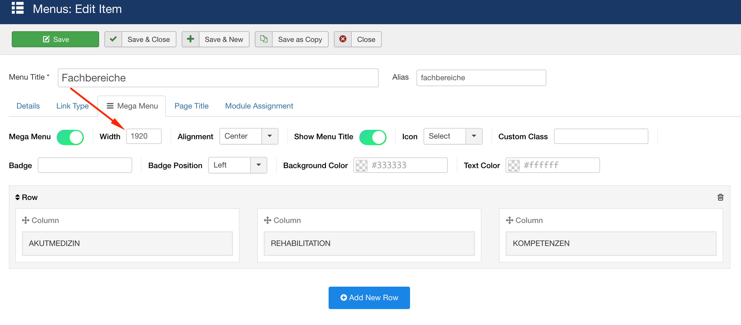

Support Agent 5 years ago #20581
Please change the width here to adjust to your screen (check the screenshot). You can also use CSS to adjust for different viewport. A sample CSS code is added in the custom.css file at the top (currently commented out).

5 years ago #21775
Hi Ofi,
thank you for taking on my problem. I could fix the issue for the menu-point "Fachbereiche" with CSS.
But the next Point "Ihr Aufenthalt" (also a mega menu) is still too far right .....
Support Agent 5 years ago #21804
I have added a custom class test-menu and added CSS to custom.css. Hopefully, it is okay now.
