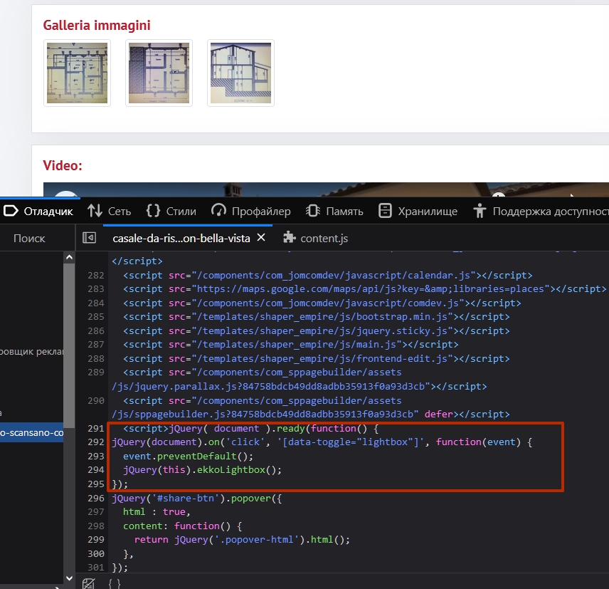

Hi. I believe that your third -party component is used Bootstrap 4 lightbox. Helix uses Bootstrap 5.
Here is Bootstrap 4 lightbox initialization.
You need to contact the developer of the component so that he will implement Lightbox for Bootstrap 5
Bootstrap 4 lightbox will not work in the Bootstrap 5 environment, because in the Bootstrap 5 no longer used jQuery
