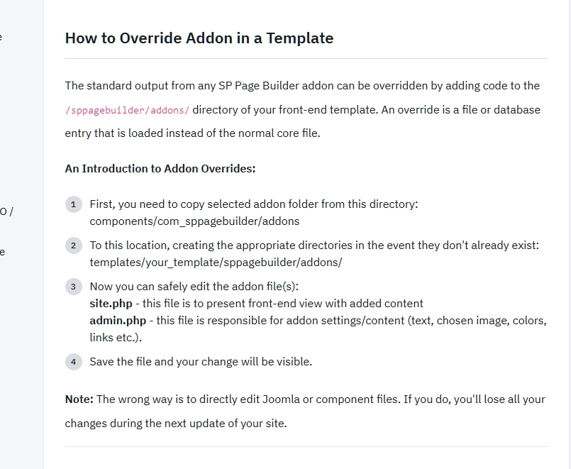

For many years, users on this forum are asking for such minor improvements. But apparently the JoomShaper team does not have this in the roadmap. Therefore, I'm afraid you will not wait for this :).
You can do it yourself by overriding the addon. Not so difficult. Read the SPPB documentation about this subject.

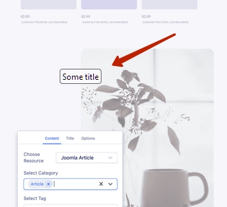

Hi. For Web Ranking is used alt and correct image file name. I do not think that you will like the appearance of your site if Title is used. Since this will be shown when hover over to the image.
Title is usually used as a hint to the link. But usually this is bypassed using jQuery/JS/Bootstrap tooltip, since the appearance of Title by default is ugly.
Do you like it?

Thanks for this hint, i'll check it.

Sorry, but i cannot find the overwriting addon part in the documentation.
Can you please guide me to the right place in the docs.
