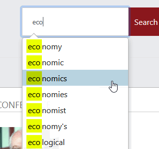

I have a search box above the menubar. With the auto complete option on, when you search, the auto complete dropdown opens behind the menu bar.
What's the proper CSS to get it in front of the menu?
https://peri.nswd.dev/ Type in any 3+ characters of a word such as: eco to trigger the awesomplete listbox.
In case of - that CSS line should help:
.awesomplete > ul {
  z-index: 911; }

That fixed it. Thanks so much!
