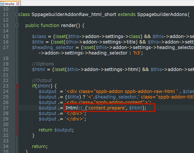

Shortcodes never work in SPPB and this is the expected behavior. You have Engage Box on board. Just use it for Convert Forms. This is a great ligament. Right inside the Engage Box, you can choose the desired form from the Convert Forms by content editor.
Actually, shortcodes can be forced to work inside SPPB. It is required to change the small line of PHP code. But for some reason, the Joomshaper team has not done this for many years. I suppose this reason is significant.

Hi Scott,
We informed about that "issue" in documenation. And I shared that solution at least 10x on the forum only this year... and I will do it again ;)
  1. Download and unzip:
    shortcode_html_unzip.zip

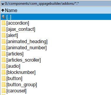

  2. Use FTP or File Manager (cPanel) and upload unzipped folder here:
Then in SPPB on the list of addons find "shortcode" name - that addon will allow you to use most of shortcodes from plugins.

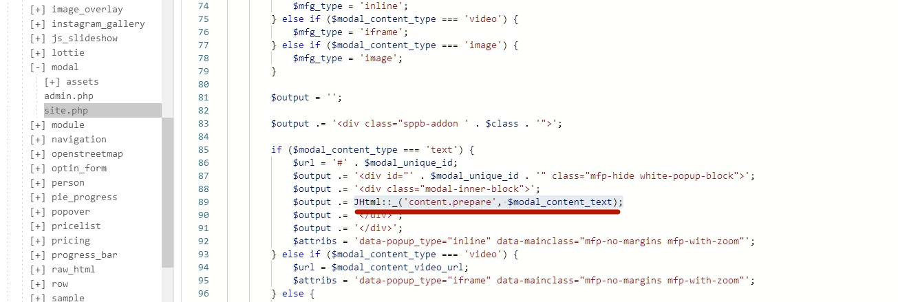

Hi Paul
Adding that code to the site is not aproblem and it's activted into SPPB, however using the short code for convertforms {convertforms 2} inserted into the SPPB Modal text area it fails to recognize the shortcode all it does is display the shortcode text in a popup box
I di read through th eforjms an dfound one whhc shows people have success with htis but it's failing. All I need want is for a short code to be add to the SPPB Modal element or button but niether work. Adding short code t otest page does not work
what am I missing
