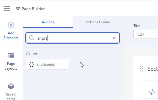

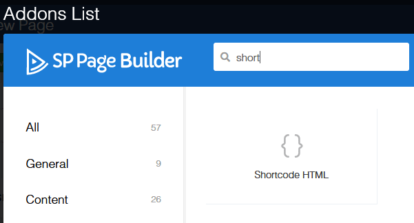

Or you can use addon that I sharedon forum many times:
  1. Download zip file:
shortcode_html_unzip.zip
  1. Unzip it, and then use FTP tool or File Manager and upload here
yes it works in SPPB 3.x and SPPB 5.x
THIS IS UNOFFCIAL ADDON, no support!

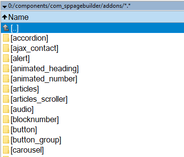

Senior Staff 2 years ago #150918
I use it on my private sites, works with SPPB 5.3 + PHP 8.x
Senior Staff 2 years ago #150919
Sorry, but Unzipped folder must be transfered to components\com_sppagebuilder\addons
It works, if you will do exactly what is shown. It was used by over 50+ forum users in many projects.
