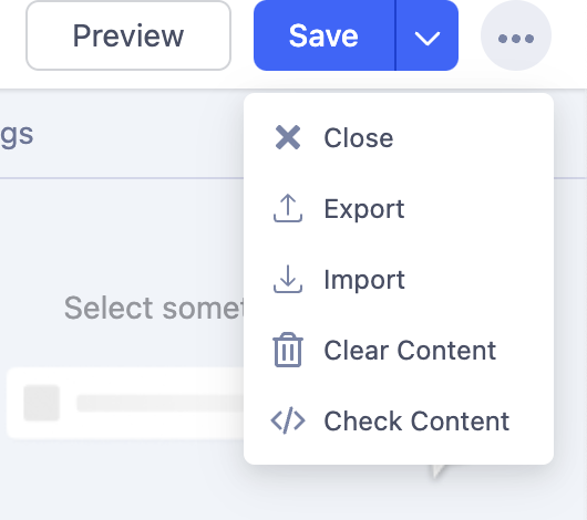

Where can I find the Check Content option?
Please open the page and click on three dots -> Check Content.
"After executing the check-content option, the problem is resolved."
Thanks for your help.
