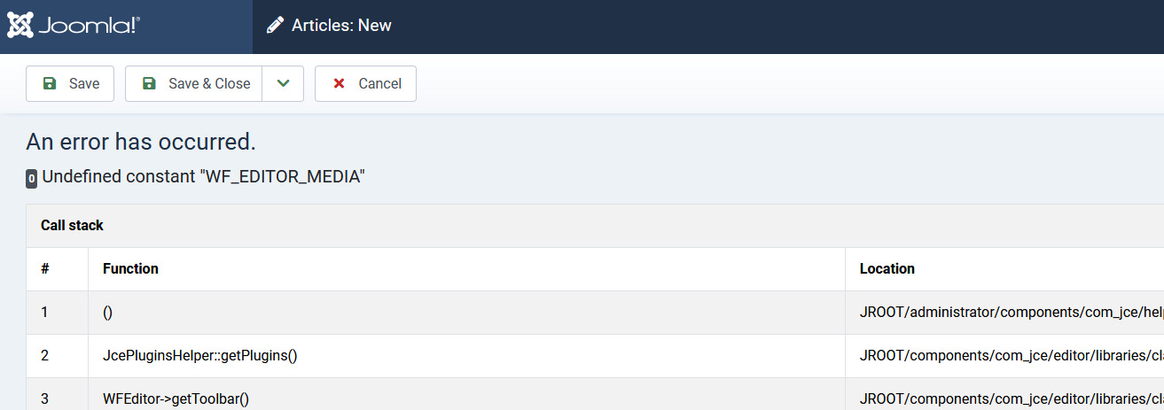

After updating plugin, theme and Sp page builder when I edit a page I see this error:
Undefined constant "WF_EDITOR_MEDIA"
(not only on a website but in some .. always the same error)
what can I do?
thank you very much
Paolo

even Google cannot find that error, so your are first one ever! Forgive us, but becuase of that we are operating by guessing.
  1. If you have JCE editor, check if you updated to last stable version 2.9.7x
  2. If you still have Sp Page builder 3.8.x it will NOT work in Joomla 5.1 (!)
  3. Switch to TinyMCE editor (Global Configuration) and test again.
  4. Do you have that error message in both editors : back and front-end?

joomla 4.4.4
Sp Page 5.3.2
JCE (which in effect creates the problem - 0 Undefined constant "WF_EDITOR_MEDIA" ) : 2.9.72
if I remove jce as editor I receive a code 500 from sp page builder
I send you the login credentials to see for yourself

You have exaclty this same error also in Articles & Custom Module becuase of JCE plugins!
Please talk with JCE developer, use his Support Forum
I uninstalled JCE totally and Articles & Custom Modules works again.

Hi. When removing JCE, it should also be removed manually its profiles from the database, as this is not removed automatically. After that, install JCE again.
