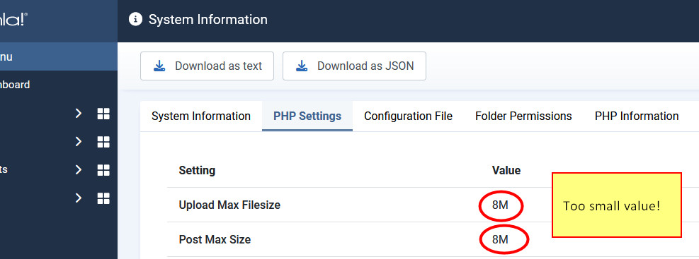

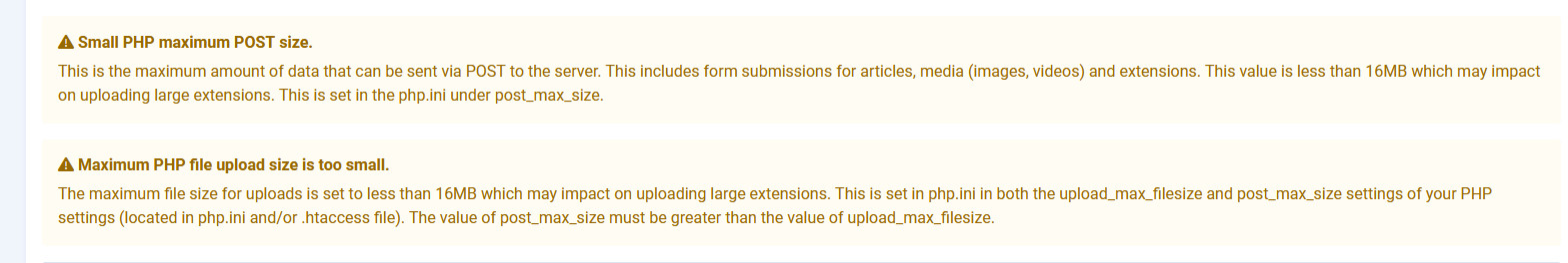

These are the technical requirements of Joomla 5.x (!) As Joomla webmaster you have to take care of it dutifully..
Useful tips about that you can find also here: https://www.joomshaper.com/documentation/sp-page-builder/technical-requirements
Maria Allen Asked this
Done. Checked the warnings and changed the settings
Thanks.
