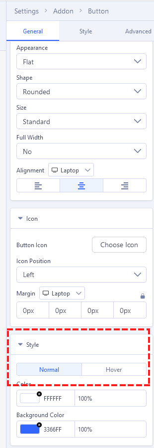

Hello Joomshaper team,
I have a small problem with the "button" addon.
When I edit the button, I'm on the "custom" style and when I go further down, to the color style, I only have the option of changing the colour and not "normal" and "hover".
I have to use the 'Button group' addon to be able to adjust the normal and hover settings.
I'm using version 5.3.4 of SP Page Builder but I already had the same problem with the previous version.
See screenshots: https://prnt.sc/8yqopx07Xt-D
Thank you for your help.

Thanks for contacting us. Could you please mention which button you are talking about? Could you please give me a screenshot of that button from site?
Probably your Button addon was overriden by template, becuase you should see that, for Custom style:
Check if you have that "button" folder here:
templates\THEME_NAME\sppagebuilder\addons\button
if yes - DELETE IT (!) with two .php files inside. Why? Ask Template developer!
As I saw you use Flex template, so this is a reason of missing features/options in our addons. That template overrides many of our addons with OLD CODE & OLD VERSIONS (!)
I am not surprised that you have this and similar problems. I have seen many of them made by Flex template over the years! Make sure that you updated theme.
Our support ends here, for obvious reasons mentioned above.
DigitM Asked this
Hi Paul,
Thanks for your feedback.
I've deleted the 2 files in question and there's no longer any problem with the "Button" addon, which displays the normal and hover styles :)
