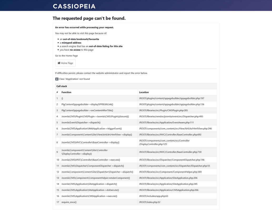

I am testing Joomla! 4.0.0-beta7 at the moment and I ran into the following problem:
If I use the SP Pagebuilder-Editor inside an article I get an error.
This is a menu item "PageBuilder page" that works fine: https://j4.ke-server.de/about
This is a menu item "Single Article" with the PB used as editor inside the article: https://j4.ke-server.de/test
Joomla! 4.0.0-beta7 SP Page Builder Pro Version: 3.7.9 (Production mode off)
Setting Value PHP Built On Linux ke-server.de 4.4.0-1127.18.2.vz7.163.46 #1 SMP Fri Nov 20 21:47:55 MSK 2020 x86_64 Database Type mysql Database Version 5.7.33-0ubuntu0.16.04.1 Database Collation utf8_general_ci Database Connection Collation utf8mb4_general_ci Database Connection Encryption None Database Server Supports Connection Encryption Yes PHP Version 7.4.16 Web Server nginx/1.18.0 WebServer to PHP Interface fpm-fcgi Joomla! Version Joomla! 4.0.0-beta7 Beta [ Mañana ] 2-February-2021 19:23 GMT User Agent Mozilla/5.0 (Windows NT 10.0; Win64; x64; rv:89.0) Gecko/20100101 Firefox/89.0

5 years ago #16706
Hi. Sorry, you misread me, I am testing J4, this is not a production website. And I wanted to let you know about this issue, as a bug report. Is there a better place for this?
I also have more information now: The issue only appears when I am logged into Joomla (as SuperUser).
Screenshot:
