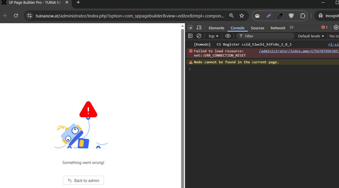

Mod security disbaled, joomla on latest version 5.3.3 SP Page builder also updated to 5.7.2
But cannot access SP spage builder pages/settings
Login credentails given , please check and let us know

burn.hard Asked this
Thanks for your quick response, but isee this even after clearing cache and trying to access the component.
Ziaul Kabir Staff
It may be an issue with your internet connection. You could try accessing it using a different browser or in incognito/private mode.
Please let me know if there’s any update.
Thank you.
If i access via VPN, then it is easily loads the page and editable
Ziaul Kabir Staff
But from my end, I see everything looks good.
