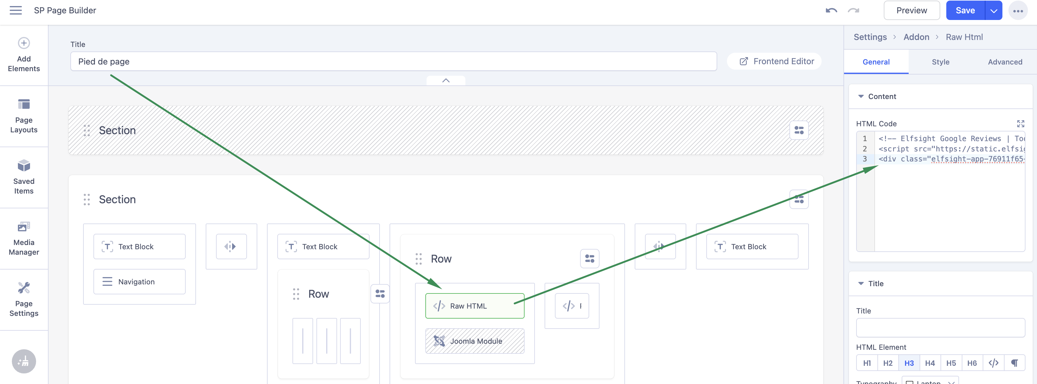

I don't know why, but on all pages I have a rich snippet code added.
see Hidden Content area for infos and URL.
this code is added by sp page builder?
L.
I have checked the site. The snippet is coming from Raw HTML addon. A script is used here and schema codes are generating from it. Please check this module (id 114).
