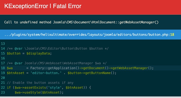

In at least on instance of an override in the Helix Ultimate Framework 2.1.3, getWebAssetManager is used, which causes the following error in Joomla 3:
Call to undefined method Joomla\CMS\Document\HtmlDocument::getWebAssetManager()
.../plugins/system/helixultimate/overrides/layouts/joomla/editors/buttons/button.php:18

Senior Staff 11 months ago #206043
please detele that file, then it should work.
But remember that we cannot support Joomla 3 anymore!

I don't use Helix Ultimate, but I am reporting this issue as a follow up to an issue reported by one of our users, using JCE Pro in Joomla 3. The same error also occurs with the core CodeMirror editor, so this is not specific to JCE.

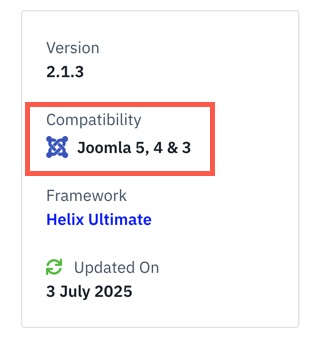

This is understandable, but the latest version of the Helix Framework can still be installed in Joomla 3, and still shows Joomla 3 compatability - https://www.joomshaper.com/joomla-templates/helixultimate

Yes, this file is not supported in Joomla 3. Please delete this override file from the specified path, and this should resolve your issue.

Please update this, and update the package so it cannot be installed or updated in Joomla 3.
Senior Staff 11 months ago #206085
I asked our team for that change. Becuase in Helix documenation I corrected that many months ago.
About 2nd, I am not sure if that is possible with template that is using templateDetails.xml as first step of installing process.
