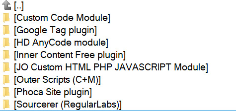

Hi Allan.
You have to install first a Module that support custom code (PHP, JS etc.) as always you will find on JED, then just use it thru Module addon.
I have those
For typical use Sourcerer is too heavy (1,8Mb) vs HD AnyCode module (1,6 Kb) or JO Custom (11 Kb) a huge difference, right
