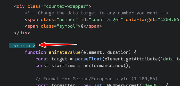

Senior Staff 4 months ago #223458
download & read: Animated Number effect.pdf
As temporary solution, try that (HTML+JS+CSS). But use it inside AnyCode module (link below), then use it inside Module addon. Implemenation is on your hands!
Remember that Javascript code must be inside (opening and closing) info__38.jpg
