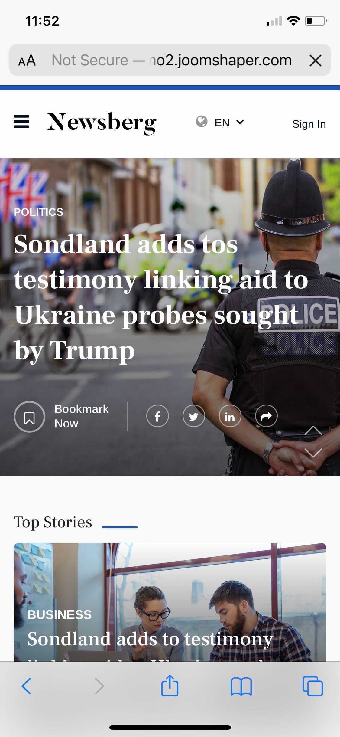

I'm enjoying testing out the Newsberg template. However, please advise if there is a way to display on some mobile phones without shifting/ back and forth / left to right while scrolling.
I notice this issue on the Newsberg demo (using iPhone 14.2/Safari):
http://demo.joomshaper.com/?template=newsberg
I reduced my site to display just the header and footer sections but it still shifts left-right on both Android and iPhone. Looks like it is recognizing padding for automatic display width adjustment.
I do not see the left-right movement on other Joomshaper demos. Also no issue on the Newsberg demo using Android.
Jim

Thanks Toufiq. The added css code did work.
I believe this issue is mobile phone and Newsberg specific. Using my old iPhone 6s (14.2/Safari) the left-right floating issue on my site is solved with the added code. However, with the iPhone I still see the left to right float on the Newsberg demo -- but no other Joomshaper demo's including NewsKit and Calicio. I do not see the float issue with Newsberg demo on Android devices.
