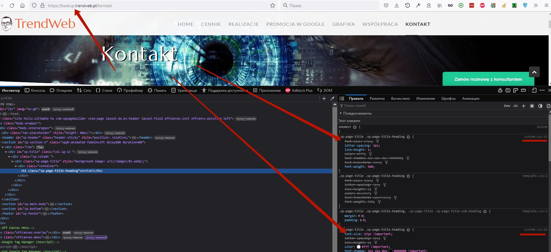

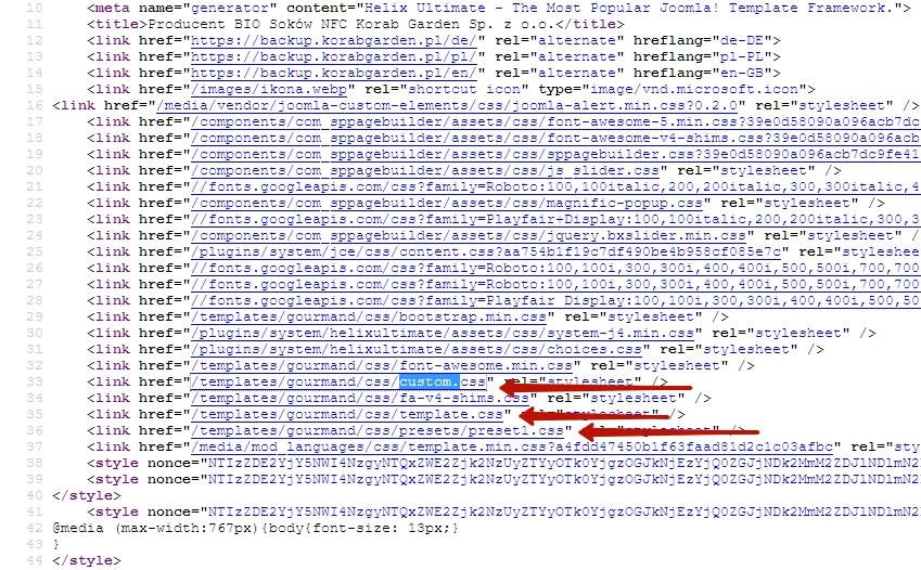

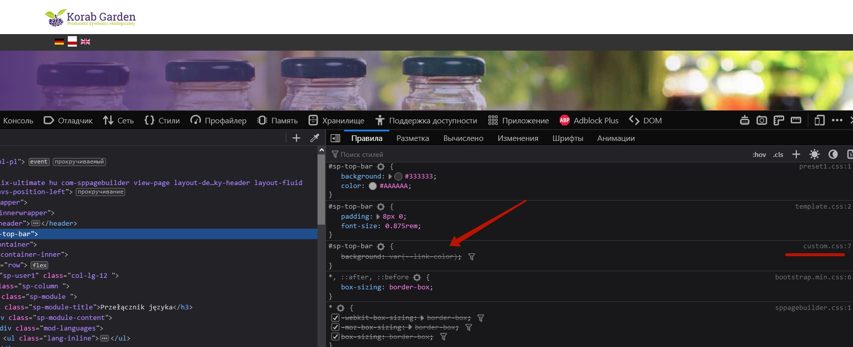

It works, just the selector is not quite weighty to override the preset. Use "!important"
The browser code inspector will answer all the questions. Use it more deeply.
But at the same time, there is a problem. It lies in the fact that custom.css is located above what should be. Therefore, you need a stronger code to override template.css and preset-x.css. This is the question of the team.

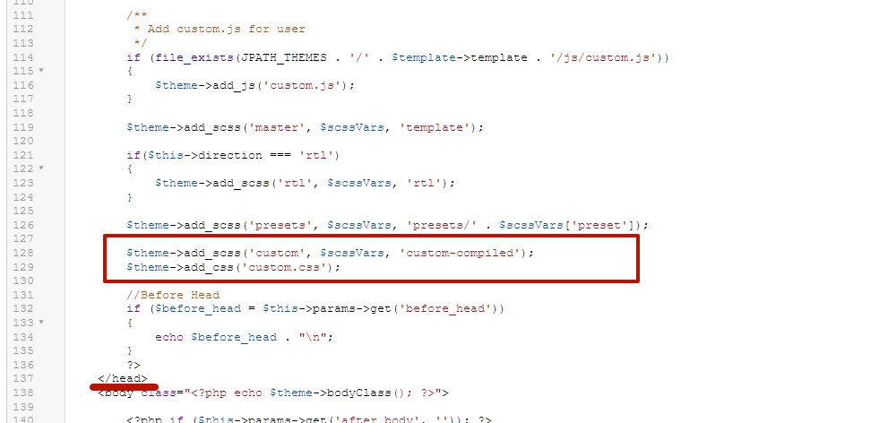

4 years ago #37368

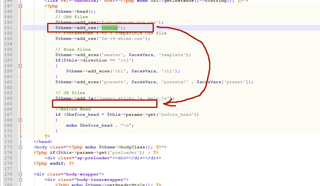

In the basic Helix Ultimate this problem is not exist. Most likely, before updating the template it will not be corrected. You can fix it yourself. Open index.php, find and move these two lines of code to the place as shown in the screenshot (above //Before Head). Do not forget to make a backup before.

4 years ago #37374
Move this line here. And check.
And maybe you will need to add an extra line under this one.
$theme->add_css('custom.css');
MN
Marek N
4 years ago #37375
great thank you, it helped

4 years ago #37471
Additionally, I want to add that for the support agents is extremely important to be able to know well the structure of the products and be able to use the code inspector. This will solve problems very quickly, instead of a multi-day correspondence to gain access. In 90% of cases, access is not required and problems are solved very quickly if you use the code inspector.
This topic is proof of this.
This topic exists 2 days. Of them to solve the problem it took two hours, taking into account the delay in the correspondence. And clean time to solve, without delay in the correspondence - 15 minutes.
