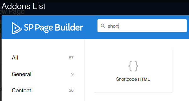

I'm glad I found this. I was struggling to make Articles Anywhere work as well. Please add my vote to the enhancement priorty list. Even better would be an add on that does the same thing
DOWNLOAD, UNZIP and UPLOAD using FTP Tool here: components\com_sppagebuilder\addons
shortcode_html.zip
Then you can use
Yes, it works in SPPB 3.8 and SPPB 5.x in Joomla 4.x

This is addon for SPPB - not module. Small but important difference.
It was based on Raw HTML addon with small php customization.
So far works perfect for all popular plugins.
