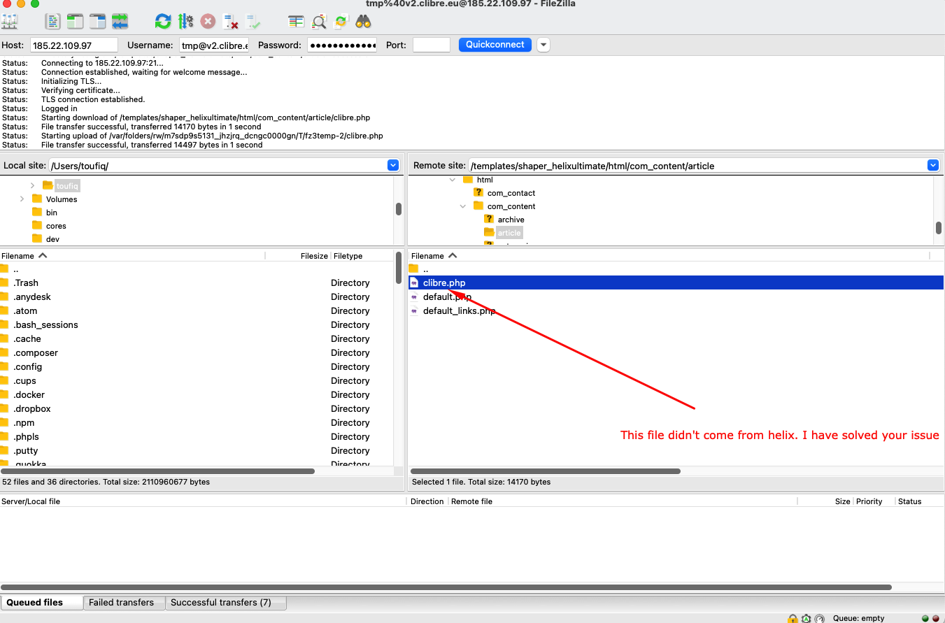

Problem is solved. Please check now. Thanks

shaper_helixultimate/html/com_content/article/clibre.php
This file is not related with Helix Ultimate. Please contact your developer. Thanks
H
HDcms
4 years ago #41350
It is an association without developer! What I would like to know is what you have done? to do the same thing on other sites that have the same architecture, not to solicit you!
I had noted that you asked to use the override! https://www.joomshaper.com/documentation/helix-framework/helix-ultimate-2/template-views-override I do not understand anything, it can work in a conventional way joomla?
2/other site https://www.joomshaper.com/forum/question/7799 is still not solved! is it the same problem?
Toufiq
Toufiq
Senior Staff 4 years ago #41358
I have removed this line of code
JHtml::_('behavior.caption');
https://prnt.sc/1y9b60e
