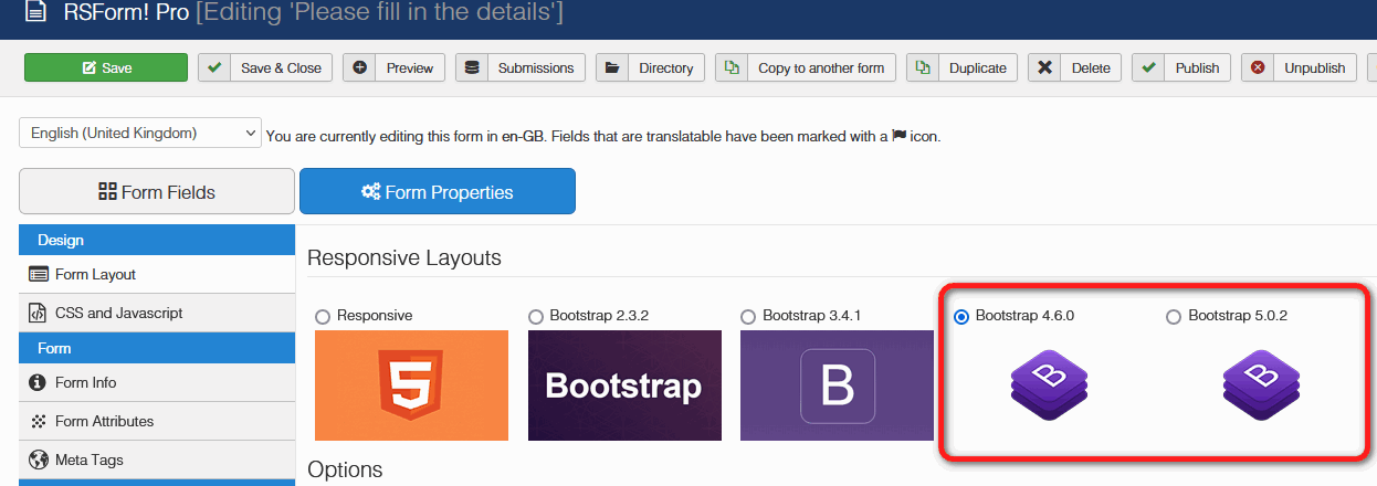

Extra bonus tip:
For Forms (created in RSForms Pro) used in Helix Ultimate use only one of those, not older (!)
why? Becuase forms looks better and .... ;]
