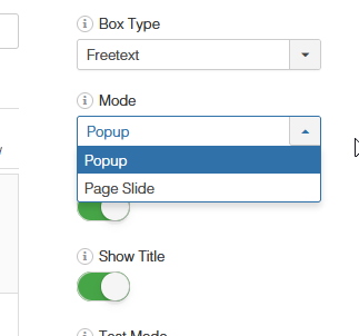

But as I know, EngageBox is popup component, and it has two modes: popup and Page slide
I don't see any extra link feature. Ask tassos.gr support. If you can have "custom" activation code then you can.
