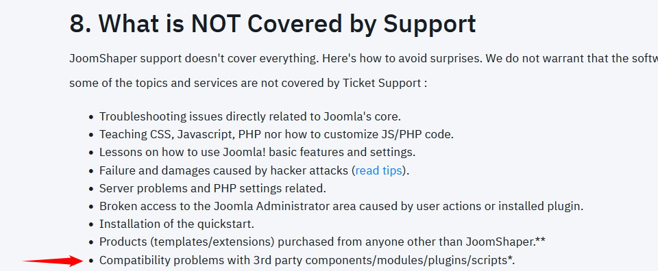

the problem of "ping-pong" is that there are thousands of extensions for Joomla. So it's not possible avoiding problems and conflicts. Joomla is not closed Apple OS where they decide what should be in Apple Store and what shouldn't be. That's why have in Support Policy info: foto_7506_2022.jpg
