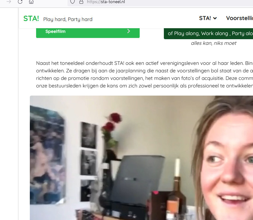

no, the example you reply with is not the video I mean, this is a video in a different extension (Tassos ACF video field). Tassos ACF works , even with lazy loading
The problem is on: www.sta-toneel.nl/help2 and I don't want to disable lazy loading.
The "rachel" example (https://vimeo.com/133642780) works though!? But this is a public one.
I don't want to use embed code, because it forces me to use other privicay settings on Vimeo.
this is the link I want to show https://vimeo.com/689711021/aa984bc9fc (not public, you need this full link) Chancing the privacy of this video doesn't work either (https://vimeo.com/689711021)
