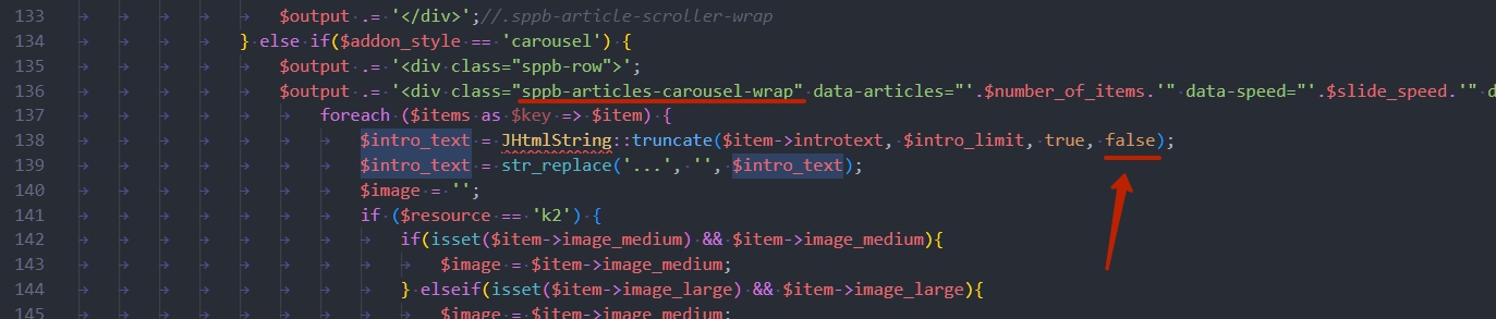

I saw in a forum post (https://www.joomshaper.com/forum/question/18276#qa-answer-88816) that in order to display formatted articles with the "Articles" addon I had to do an override by removing the "strip_tags" value, but it is not present in the "site.php" file of the "Articles Scroller" addon.
Can you tell me what I need to change in the code for this?

Hi. I haven't tried it yet. Therefore, purely theoretically (for carousel mod), try to change this to true.
It's should allow HTML
My assumption is based on this https://api.joomla.org/cms-3/classes/JHtmlString.html.

Great it works, thank you very much Pavel
