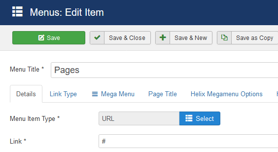

But much better is to use "URL" (external link) menu type and use "#" as link for it.
Separator doesn't work in mobile menu and "URL" does. I use this method since first Helix and works every single time.
