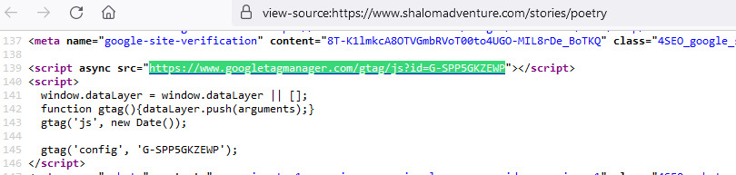

I have added Google tag code to my Gazette template but am not able to see the code appearing on any pages. I am wondering if this is a problem with the template of if it might actually be caused by our use of JCH Optimize to optimization. However, I did turn off the JCH Optimization and cleared all the cache files and still was not able to see that Javascript.
Since we are not using the Cloudflare CDN we need to look at this at the Alternative URL of the Origin server.

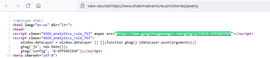

We solved this issue by
  1. listing the google js scripts in the exclude field for JCH Optimize to not defer those scripts to the bottom of the page.
  2. Removing the scripts from the template and only having them in 4SEO.

I checked few subpages and JS Tag code is used, but becuase you have 4SEO component it's used also on the top. Example that same subpage, google tag code is used 2x:
  • 1-st from 4SEO
  • 2-nd from Template Custom Code area
I think it's an answer to your question.
