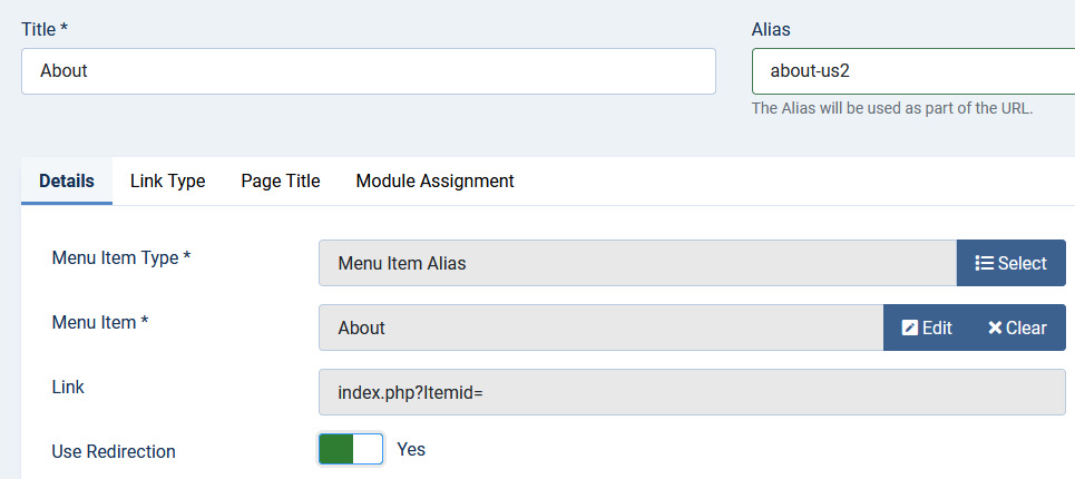

  1. Use different alias - just add "2" at the end or extra word
  2. And Use Redirection: Yes
  3. Yes, it will work than, and it's still SEO friendly.

Thanks, Paul. I noticed I could do as you mention, just modify the alias, but that seems like an odd workaround... home, home1, home2, etc., and results in messy URLs. So, I was wondering if maybe I was missing something, like a different, better, way to add the Home link in the footer.
It will not mess URLs- check what real alias is used after, preview bottom/footer link(s), you will see.
