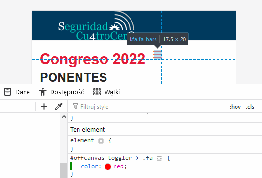

Hi Marcos ,
Read whole tip 6. >> https://www.joomshaper.com/documentation/helix-framework/customization-tips#how-to-change-the-color-of-offcanvas-menu-icon-usead-in-header
by default [=] icon is white, here is example how it would look in red
use that Custom CSS from screenshot.

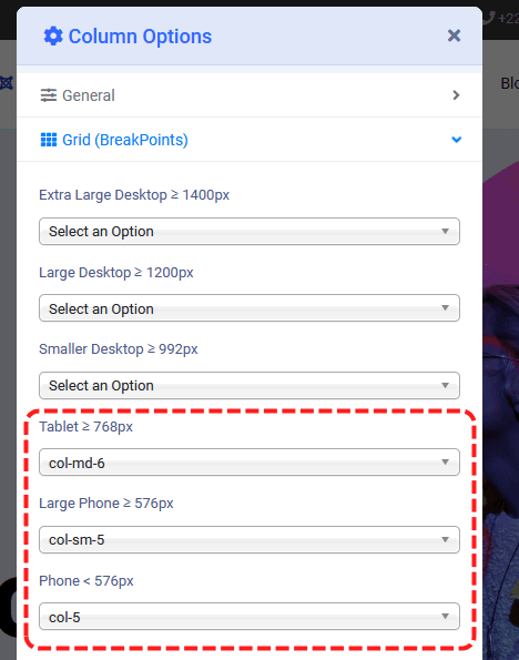

But in your case, you have to correct columns width, menu for mobile is too wide and logo max "6" for Mobile view. Template Options > Layout > Header > Logo Column Options and Menu Column Options. Set that for both columns (!)
