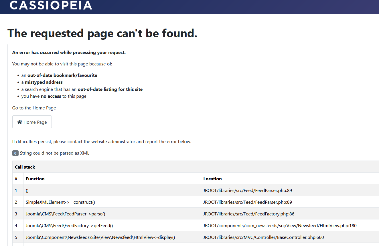

I and am getting the folllowing error on all my newsfeeds
String could not be parsed as XML
I have turned on debug, you can see the issue https://www.dorset-aptc.gov.uk/members/nhs-dorset
The feed link I am using is https://nhsdorset.nhs.uk/feed/

Hi Alison,
but Helix Template do not overrides newsfeeds component, and never did.
Anyway, I will try to look and maybe suggest something.
I checked and you have exactly the same errors on Casiopea template. It means it's Joomla Core problem Or you used wrong URL for feed source (!?) Search for alternative extension, or ask again on forum.joomla.org.
Try to use Feed module first, to test if all used links are 100% correct. Some websites locks reading-displaying feeds on external sites to protect their SEO. I do that same in my blog site.
