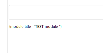

My test results with Custom type module "TEST module":
  1. It worked in template module position
  2. It worked inside Page (SPPB) inside Module addon
  3. It worked in Article put as shortcode
So my research ends here. Now is your turn to dig.

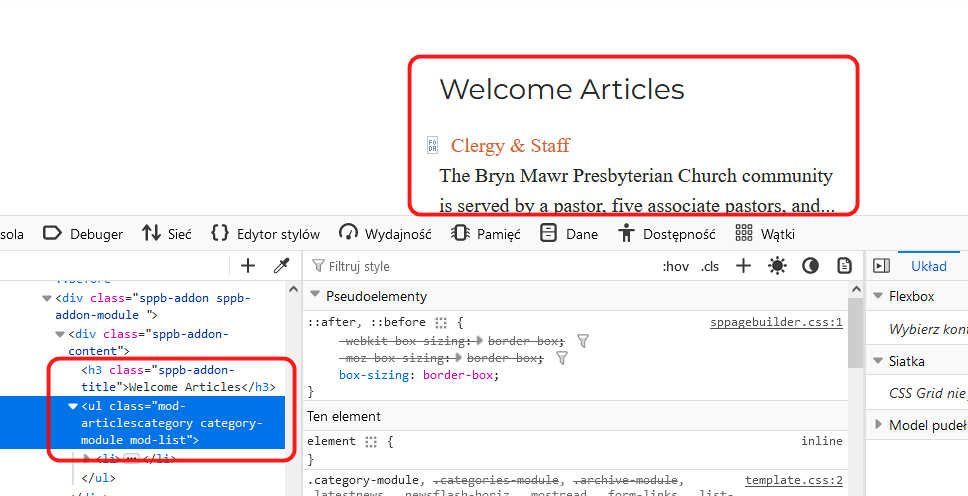

I set up a test SPPB page and inserted four different types of modules on the page --
  • Joomla menu module,
  • Joomla Articles-Category module
  • DOCman module
  • Joomla Custom module
Every module is set to show on all pages.
I created a menu item that points to that page.
Only the Custom module appears.
URL below.
I see "mod-articles-category" on that page, not custom module.
You changed login details, so I cannot check anymore :/
