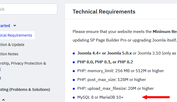

The problem is SPPB not working. when i try to create page its getting 42601, 7, ERROR: syntax error at or near ")" LINE 2: () VALUES i have used postgresql, is this issue with that? because it's properly working with mysql. is SPPB not support with postgresql?
It may be that reason. I will ask developers to check that topic.
I hope you can use MySQL/MySQLi by now.
In our SPPB documenation we informed of supporting MySQL & MariaDB just in case.
