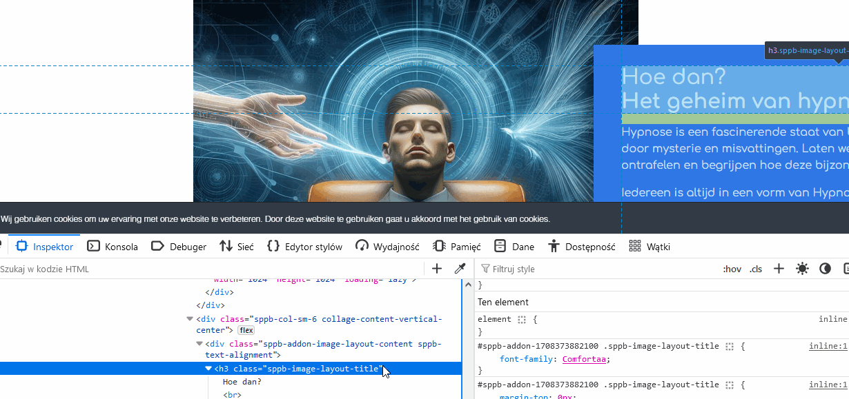

I'm having problems with the Image Content add-on.
The added text is shown in the correct font in the editor, but the selected font is not shown in the preview or live.
It is regardless of which font I use.
I also used different browsers.
The correct font is shown everywhere, except for Image Content add-on.
Can you help me. It looks like a bug.
4 replies
Hoi,
from what I see , Comfortaa font is used.
In that same font should be used for all headers H1-H5 - just set it in Typography (Template Options) and no need to extra select in each addon. But I guess, you did it already.
Microcenter Asked this
Hi Paul,
Your right about the first answer, but that is not a Content Image module you looking at. :-)
Your second answer did the job, but ist is strange that there is a difference between the editor and the live-view/preview. But it is what it is. The site looks fine now. :-)
Thank you.
ad 1) Opss. My mistake. But I will check on my demo and talk with developer.
ad 2) :)))))
Please look down
I think it's not, only the title shows up in the right font. Right?
Oh, I thought that you had problem with Title.
The title was in the right font everytime, the text was not oke
