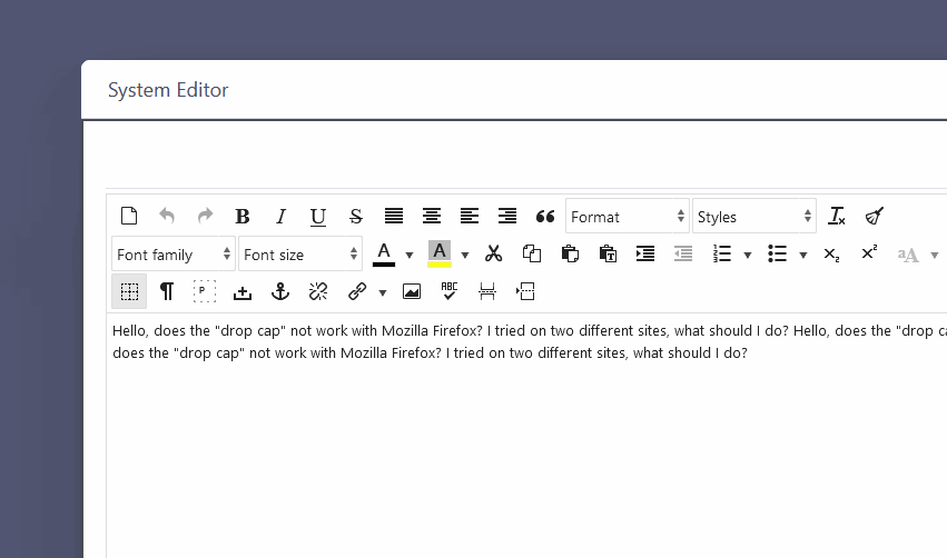

Joomla 5.0.3 + JCE Core 2.9.62 + SPPB 5.2.7 (no Ark installed!) TODAY'S Screenshot
