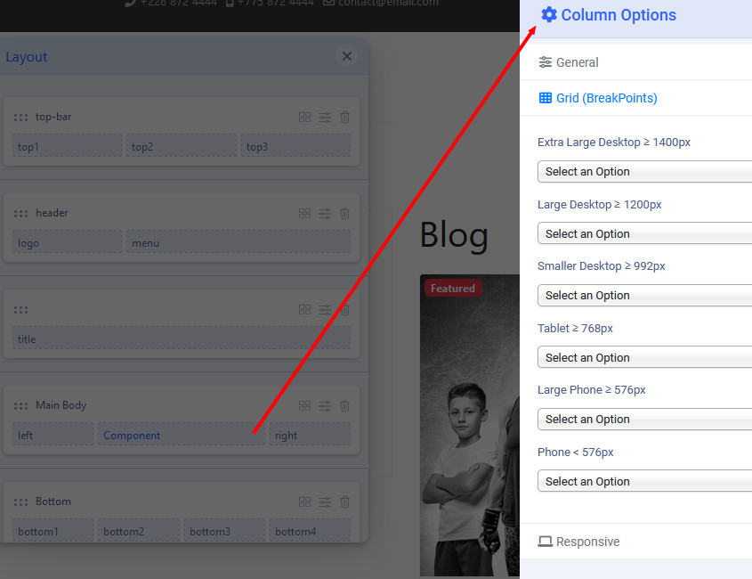

Hi Gerald.
it seems like this should be easy?
Yes, and probably you set it one day in the past, and forgot about that.
Template Options > Layout > Component > Column Options and everywhere must be "Select a Option" or "Inherit" ,but not 12 as you probably have. It's simple "grid math".

Thank you, yes that did it.

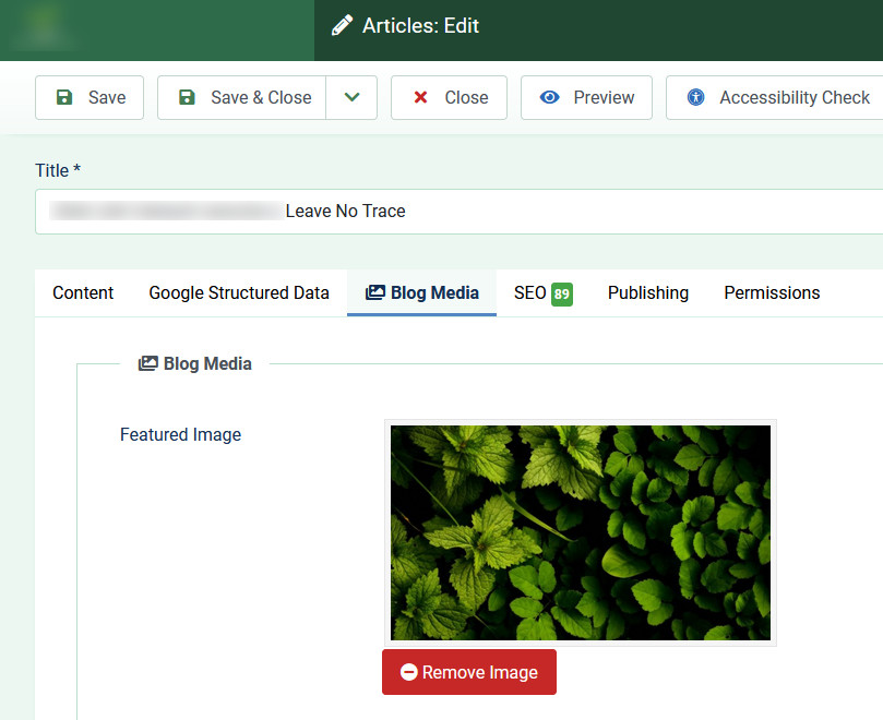

Also, without hacking the articles template php file, is there a way to make the template display the article main image? thank you
If image will be used in Blog Media (tab) - yes, then image will be displayed at the top of article. Screenshot from my site.
