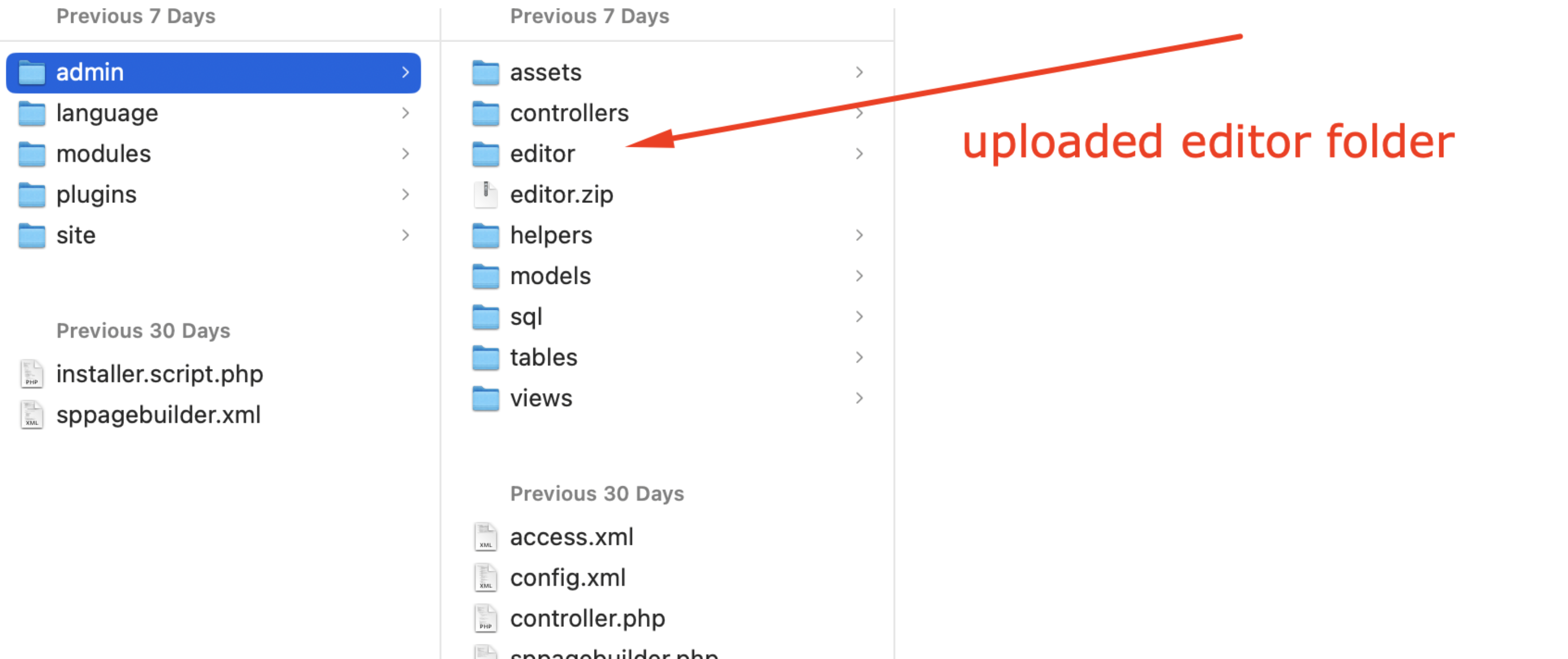

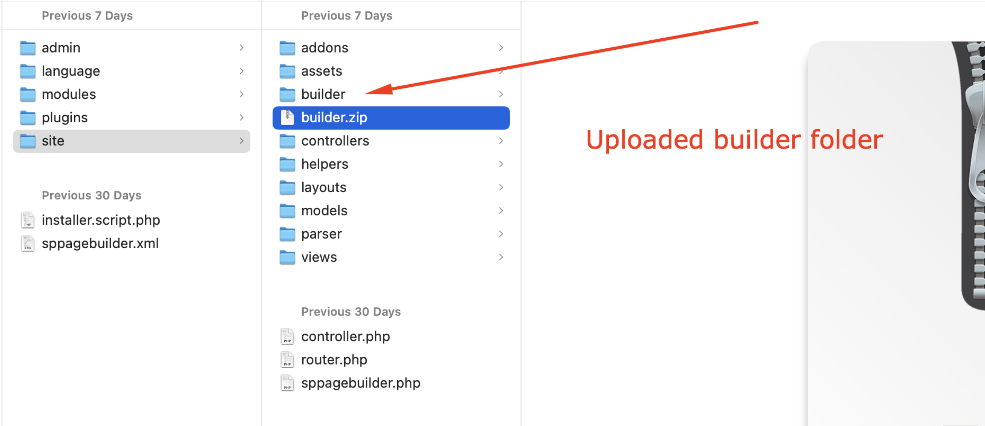

The screenshots above are not showing up for me. I am having the same issue and would like to know what folders I need to upload via FTP.
administrator/components/com_sppagebuilder
These folder was missing. That's why need to re-upload these folders via FTP. Thanks
